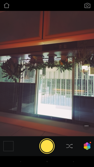

A highly frustrating bug that's either specific to the 5X, or in Mashmallow in general:
In any app other than the official camera app, photos appear upside down, and (I'm pretty sure) with a skewed/distorted perspective.
I'm attaching a shot from Camera 360, but it happens in multiple other apps (including one my bank uses to take images of checks). HIGHLY frustrating, especially when Google really stripped everything except a shutter button out of the camera app.
Anyone else having this issue?

Thanks! Though to be honest, it doesn't do a great job showing off the N5'x camera! That's why I think it may be something that developers need to update apps for - which is what I was told when I posted the issue to Google's Nexus help forums (though not by a Google employee, as far as I can tell).

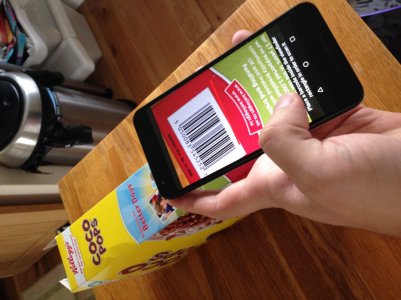

Hello, I'm seeing this on my new Nexus 5X in certain apps, namely; MyFitnessPal and SkyView Free. I've tried the figure-8 gyroscope recalibration, a gentle knock whilst using the Accelerometer Calibration app, and a good old power cycle, but to no avail.
I've the latest of all updates for hardware and apps and as noted by others it only seems to affect certain apps.
EDIT/UPDATE: I've spoken to Artie from MyFitnessPal and have passed on my device details and photos of the issue, hopefully it is a software issue as noted above. Interestingly in the photo below you can clearly see the MyFitnessPal app text is upright, but the camera is upside down compared to the barcode and device.
