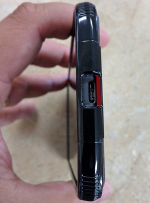

Bumper fixed! Here's my solution:
At first I tried just removing the material until it was flush with the cross-brace section, but that wasn't enough. I had to make the cross brace about half the original thickness. Now the charging cable snaps in confidently without any extra thought or effort. A bit disappointing they didn't just design it correctly to begin with, but at least it was easy to fix.

You might have it, but I'm not quite sure. Basically it is only removing material from one spot. I just went so far, tried it, and found I had to keep removing material. Overall, I removed the area highlighted in red.

I believe someone else mentioned removing a bit that the style backs catch on. I haven't removed that (yet).
Perfect, this is exactly what I wanted to know. I was thinking that I could pull the case "down" when I wanted to charge but would rather have a permanent fix.
Question - any concerns with the integrity/stability of that portion of the case now that it has been modified? Like are you worried it might break right there?

No concern at all, seems very solid. Barely moves if I tug on it.

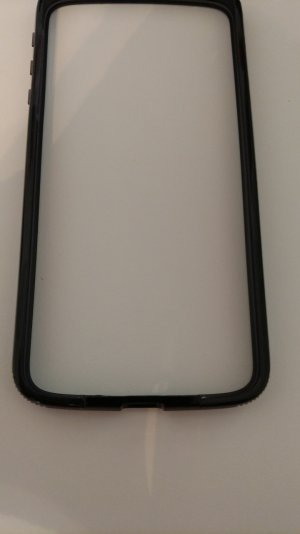

Correct, I removed what YAYTech outlined in red but I also ground down that tab on the back bottom of the case I circled in red below.
I took that down just enough so it isn't hitting the style shell. My bumper wasn't sitting flush on the bottom of the phone because of that.
