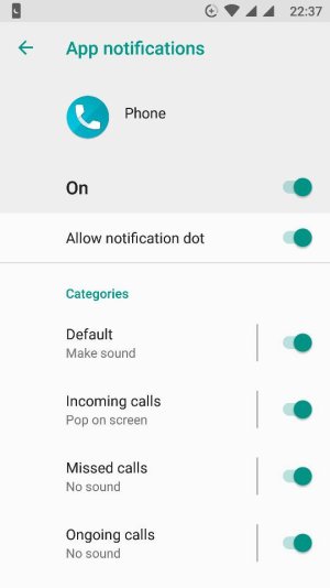

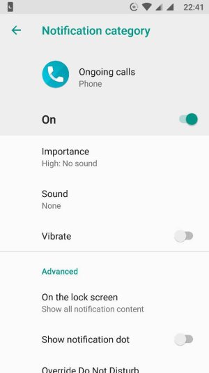

Strange. Just in case, what do you have in settings - apps & notifications - see all xxx apps - phone - app notifications? Also, tap "ongoing calls" and see if you have set any sound in there.
Nothing unusual about my setup! I also just realized that with an incoming call the Moto default sound plays once then my set ringtone kicks in. This is all very strange.
