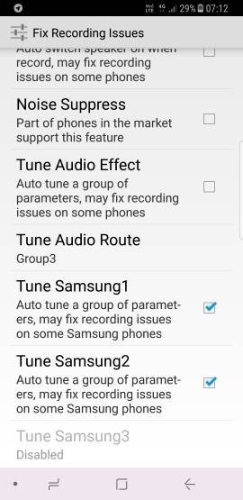

For info, to anyone wanting to try it out, make sure you change the settings, as recommended by the dev.
