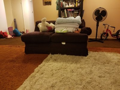

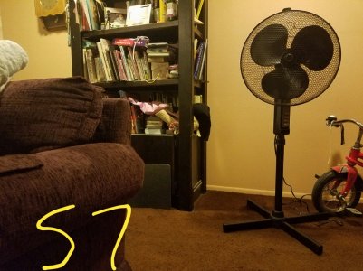

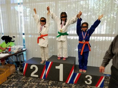

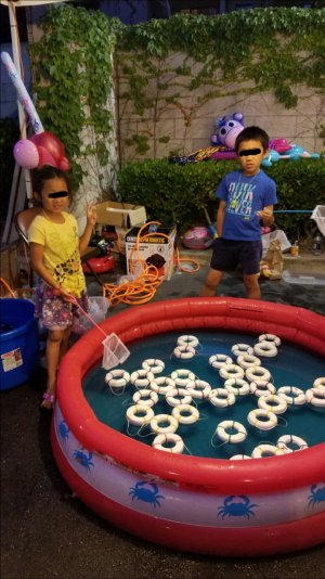

I have a Verizon Samsung S7 that was purchased in April. Didn't buy any insurance. I have been noticing distortion from the rear camera. I've been Googling it and there are not many posts. I saw one on Redit and nothing ever came of it. I've been told in the photo thread that it is part of having a wider angle lens. I never noticed any of this with my S5. The S7 is a good, fast camera but the faces bother me. Faces get stretched toward the center of the picture and it doesn't look right at all. In the first picture, the kid on the right is very stretched. My kid in the blue gi in the second picture is stretched enough. I've added other pictures of the fan to demonstrate what I see a lot of. In portrait mode, if I don't angle the camera correctly, heads get elongated. I don't want to try to angle the phone every time I want to take a picture. I've been trying to look at sample photos on the web too, they look normal. Verizon and Best Buy won't do anything. The Samsung guy at Best Buy told me to go to the service center. What do you guys think? Anybody else notice this stuff? On the pictures thread they all look great and I can't find the flaw. Thanks for reading this long rant. -Gene

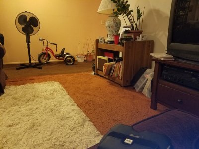

The S5 lens is spec'd at 31mm while the S7 is spec'd at 26mm. The S7 definitely has a wider lens so I wouldn't expect both phones to take the same photos from the same distance. Not to mention that you'll see more distortion coming from the S7... especially at the edges. Take a look at the curve in the TV chassis and TV stand leg in your second fan photo... not to mention the slanting of vertical lines of the wall to the left and the bookcase in the last two photos. Typical of wide angle lenses and exactly what I would expect to see.
If you want less distortion in your photos, especially people's faces, then you need to step back, zoom in, and frame your subjects. In the old days of 35mm... the recommendation for portraits were lenses in the 90 - 105mm range. This ensured the subject's face was less distorted horizontally and vertically. Even back then, (and still now) if you shoot a portrait using a wide angle lens, distortion will occur for sure unless you are very careful about distance to subject. And... to alleviate more possible distortion, you need to keep the subject centered in the frame. The reason the last picture of your fan is round and straight, and those round things floating in the pool in the first photo are in fact round, is because they are all framed in the center where the lens has the least amount of distortion. It's the nature of the beast for wide angle lenses that anything outside center frame will be more distorted... leaning, slanted, or stretched (if you want to call it that).
All that being said, yes, the problem is because the S7 has a wide angle lens... for sure wider than your old S5. Whether you have to live with it, the answer is also yes... if you keep the S7. However, you can also learn more about photography and remediate a lot of the problems so you're not so bothered by them.

Yeah, that's some mean slanting of the wall and door in the second to last photo.

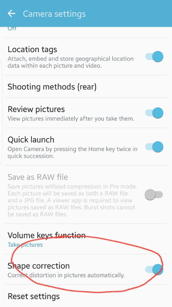

Isn't there a setting in the camera for auto correction of distortion? Have you tried that?
Also, I wonder if changing the metering from center (default) to matrix would help.
There is only shape correction for the front camera. I have read that there is an update for other versions of the S7, but nothing for the Verizon version
Could you point me in the direction of what you have read about other carrier's patches for distortion? I'm on T-Mobile and would love to know! Thanks in advance if you can enlighten me!
Galaxy Gal from 1-7!

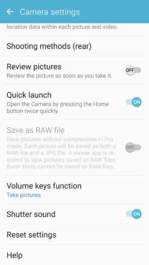

I was under the impression it also worked on the rear camera
This is mine on Verizon. Definitely carrier dependent, I suppose. Although I have not updated to the latest security patch yet due to complaints on this board. I always wait and there is no description of a camera fix.

I didn't realize that I can turn off the corrector, which I did, but it didn't make much of a difference. It just made me look a bit fatter I think. I just want pictures of me and my kids to look like us. Not skinnier/taller/fatter/shorter versions of ourselves.
