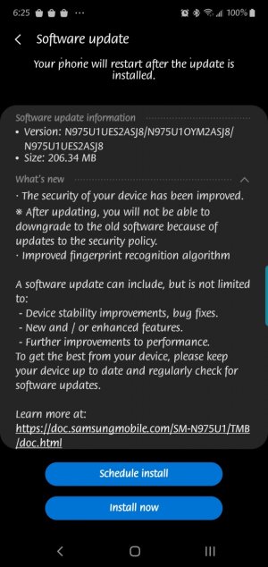

I got an update a few days ago, but I still get this message.
Which firmware update do you have? Is it the one that's been reported to fix the problem? There are multiple messages in this thread that say which firmware version fixes it.
I'm guessing it was the November security update. I got it on the 1st.

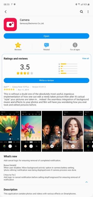

That's a workaround, not a fix. The camera should work properly without having to disable background management for the app. And the latest version (9.5.01.5) fixes the problem.
I seem to have the latest update according to my settings but still had the problem. How are people getting updates I can't get? I have an unlocked version. Also, where would I see my version number? Thank you.
One other thing. It says that if you don't close the camera right away you won't get the warning. So is just a work around for those of us who take a photo and close the camera, I think.
