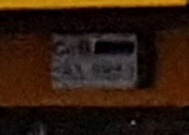

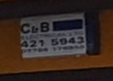

Now.. these pictures. Looking at the snips you posted, it does look a bit off. That isn't a focus problem, that looks like a processing problem to my eyes. My wife has an S7 and I've found that that thing processing the ever living hell out of images at times. They look great on the phone display but once she takes them off and on to her laptop, you can see it, especially when compared to my 6P. She cares nothing about camera sensors and pixel sizes and all... but on many occasions, she mentions how my shots look a lot better than hers when she crops and resizes to put in, say, a Shutterfly album.
I don't have the originals to verify it, but I think what you are seeing might be the result of Samsung going overboard with the processing software on the S7... I have yet to figure out why they did so... on paper, that sensor should be able to do more with less processing than the previous generation sensor they used.
Here's what I mean.... look at these two little bits here. The S6 image shows processing effects, hence why the clarity is inconsistent, but the S7 completely obliterated it. That has to be software.
S6:
S7:
I might grab my wife's and take two sets of pics... one using the auto or pro mode stuff and a second with RAW. That'd be telling as to what is going on.
Yup. The RAW photo would remove all processing effects. Would be tedious to always use RAW though. I wonder if using a different camera app would help.
Tedious, yes, but just as a way to see how much it's processing.
I think ProShot allows you to adjust the amount of sharpening and noise reduction.
