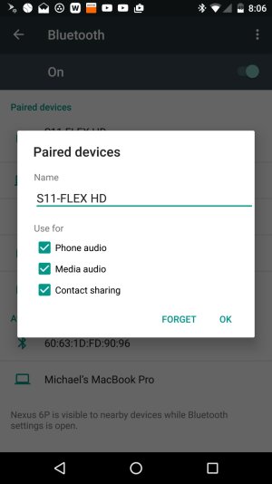

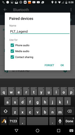

On a Nexus 6P, I have those options with both of my headsets (see screenshots). The S11 is a stereo headset that can work for both music and phone calls, the Plantronics I use as just a phone headset but it can be used for media also (I leave that disabled in the PLT app).
When I disabled the media audio on the Plantronics headset it reverted to just phone call capability and directions didn't go through the headset but with media enabled the map directions went through the headset.
When I did the same test with the S11, with media disabled it disconnected the headset and didn't reconnect until I re-enabled the media option. This may be a limitation of that particular headset.

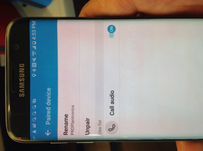

Thanks for that info and the screen shots. That's exactly what I'm looking for but looks pretty different from what I saw on the Galaxy S7. I attached a photo of what I saw on the Galaxy S7. Should all Android devices have the capability to customize the bluetooth profile? Maybe the Galaxy S7 can't do it?
What you may need, that I have on my phone, is the PLT hub app. That allows me to adjust settings like that on the headset. In fact, with that option turned off in the app (which adjusts settings on the headset itself) I lose the media audio option in the settings.
