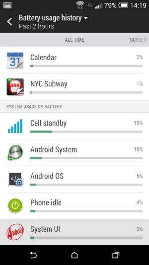

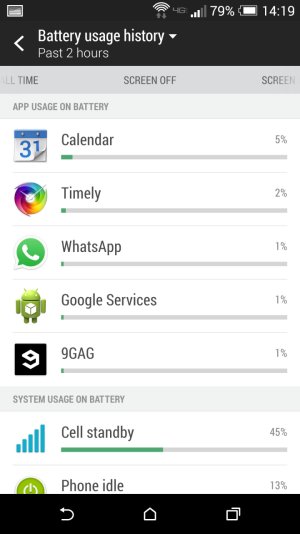

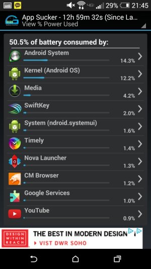

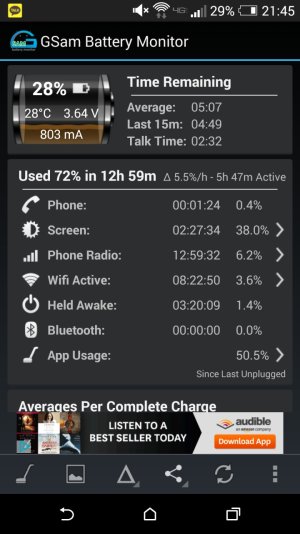

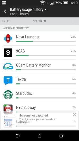

Re: Help analyzing Battery life (with Gsam Battery)

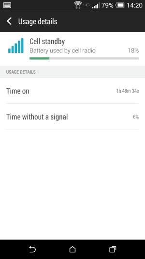

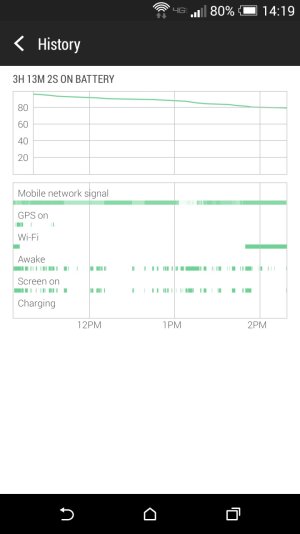

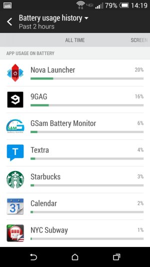

Hi P Diddy,
Please see attached for my screenshots, anything that looks off? It seems like Nova Launcher is taking up a lot of battery...and for the GSAM Battery Screenshots, is it normal for the Android system and Kernal to be taking up most of the apps battery %?
Thank you!!

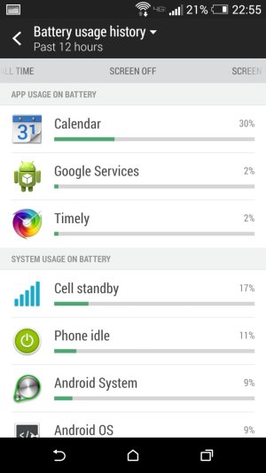

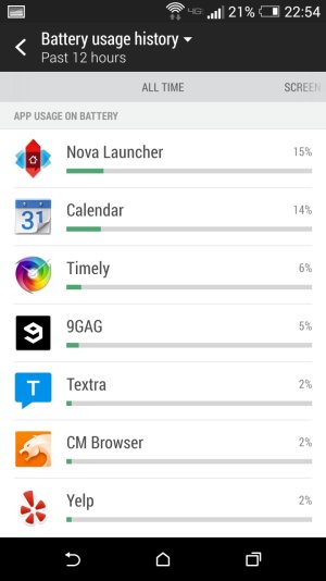

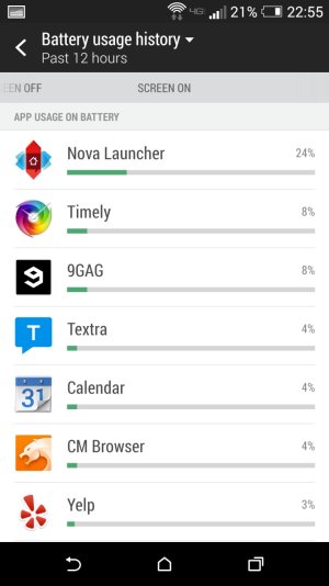

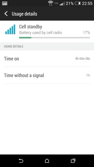

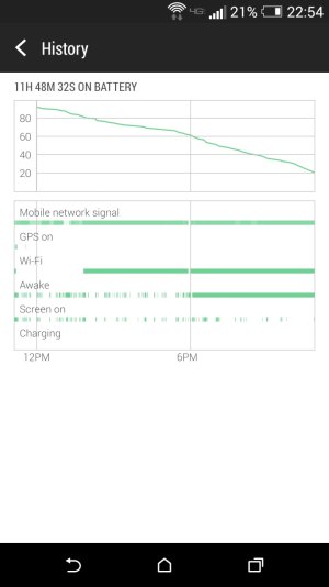

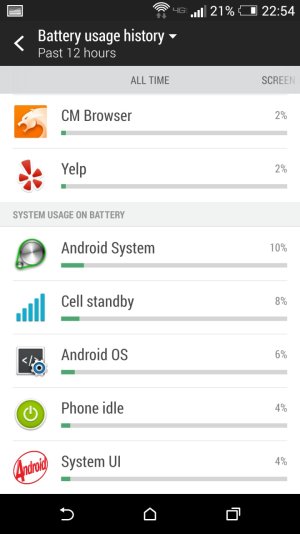

Hi guys,
I got it down to 21%, please see screenshots. I'm wondering whether Nova Launcher and Calender are the problem???
Thanks so much!
Something is keeping the phone constantly awake from 6 PM onward, which is probably contributing to battery drain. Tap some of the top battery-using apps and see how much awake time they're contributing.
I'm sorry but how do I do that? I tapped on some of the Apps but some have "Screen On" and some have "Keep Awake". I noticed Google Calendar have "Keep awake" of 19 min 27s and it's the 2nd biggest draining app. I just used Greenify on it and the drain on my battery has suddenly slowed. Maybe that's it???
Sorry, I'm not used to the M8's battery stats. I got a chance to look at my wife's M8 just now. Look under the "All Time" screen, and tap Nova Launcher and Android System, for starters. Some apps will show a "Keep awake" stat--that's what I'm interested in. I'm wondering what kept your phone awake for about 5 straight hours starting around 6 PM.
