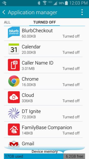

I use an app called Today so I turned off Calendar. Obviously it's possible. It WAS a problem when I turned off Calendar Storage though. Now it only shows what I want. Maybe's it's grayed out if in use or something...Screenshot_2014-11-18-12-03-35.jpg

I use an app called Today so I turned off Calendar. Obviously it's possible. It WAS a problem when I turned off Calendar Storage though. Now it only shows what I want. Maybe's it's grayed out if in use or something...View attachment 148904
