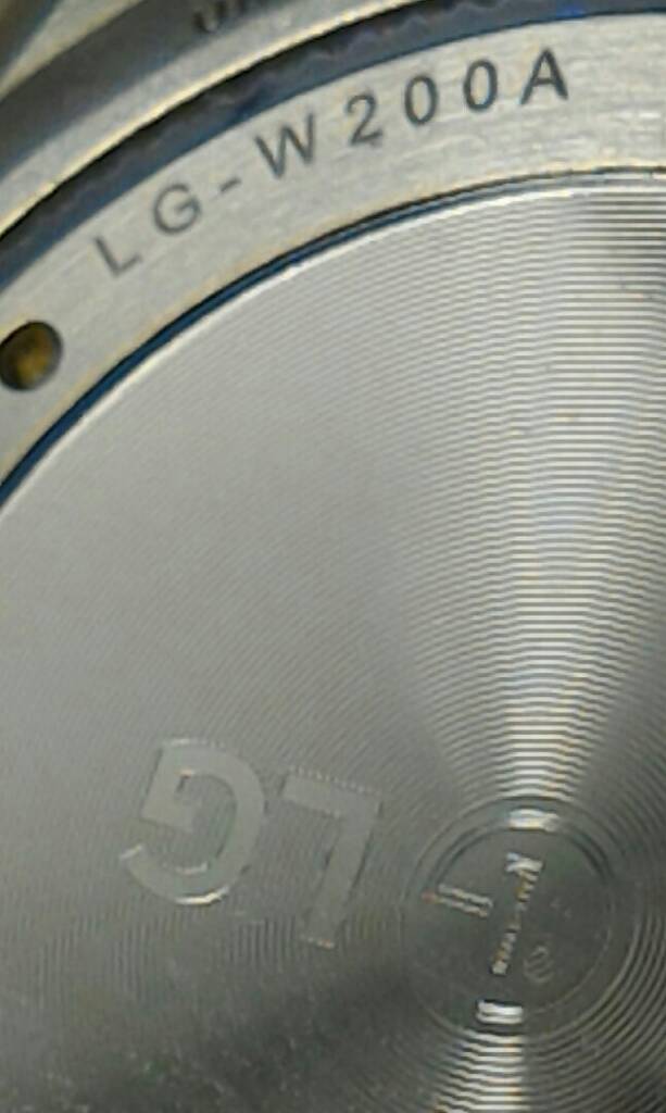

It seems like it can read the SIM card fine, but can't find a network. Just curious as it wasn't mentioned above, but which model did you purchase? I'm fairly confident only the AT&T model has the right bands for Canadian networks.
Sorry to be so ignorant but can you tell me how I can know which model I got? And from which original carrier?
I bought it from someone in the US. I ask him from which carrier it was and didn't get any reply yet...
Settings> about > regulatory information
What's the FCC id? Ending in w200a is AT&T model. w200v is Verizon.
Mine is the w200a version (att), got it 8 month ago and works like a charm on Videotron using LTE. I have AW 2.0 dp3 installed on it.
Under regulatory it says "complies with IDA standards DB 102260 Republic of South Africa ICASA TA-2015/1601
That does not look good :( lol
Can you tell me how I can get the model number?) I am not sure if it is a W200a??
Do you have the original box?
If it's mentioning anything about South Africa I can guarantee it's not the W200A model, unfortunately. So that leaves you with 3 options. 1) try to return to the seller, 2) sell it yourself, or 3) use it with bluetooth/wifi only.
