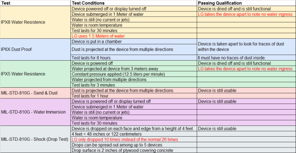

Attached chart to show LG's tests for IP ratings and for their MIL-STD-810G testing. Note, they did do 11 more tests for the latter, not included in this chart. These are noted on the link previously shared.
As can be seen here, the IP Water Resistance and Particle Resistance tests have higher requirements for the test itself and for the requirements to pass the test. In water resistance testing, LG went above and beyond minimum standards for their IP68 ratings, making it that much more an improved test over the 810G counterpart. They added an additional 50 cm of depth which adds more pressure, etc. and they are validating that water ingress did not occur, not simply that it prevents the device from being usable.
