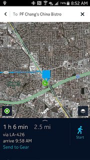

- theres is no way to send route information from HERE to the Gear S. (option is missing from HERE)
Navigator for Gear only supports walking and transit directions and that's what is available to transfer from Here on your phone. If you have a walking or transit route open the "Send to Gear" option appears.
