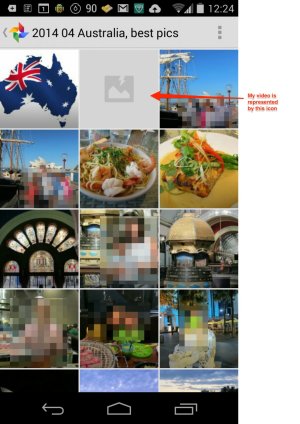

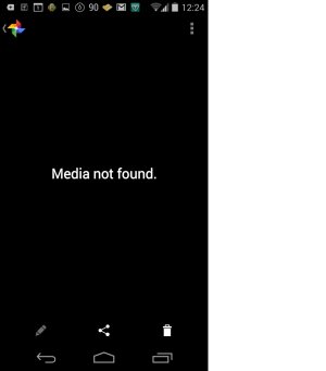

When I open the the Photos app and view one of my media folders (containing pictures and videos, jpg and mp4 file types) Photos app shows the pics okay, but not the videos. When I tried to open a video photos app reports on a black screen "Media not found." Furthermore, if I tap the centre of the screen (where the "message media not found" is displayed) the message is replaced by "Can't play video" error message in the centre of the screen. See attached screenshots.
