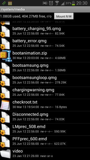

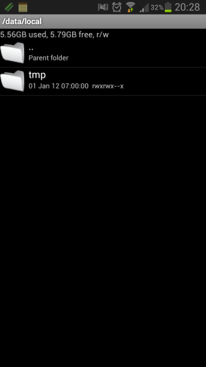

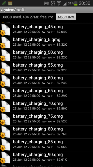

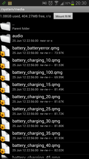

Why it didn't work on my sgs3, I've already do anything like you do, but nothing change, give me your suggestion please?
