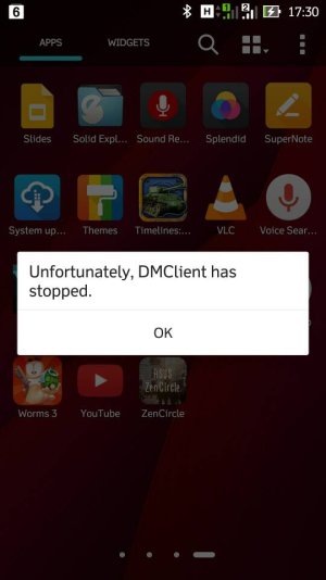

I bought a ZenFone 2 via gearbest (can't buy it directly in my country), and so far it's been a great, although flawed experience.

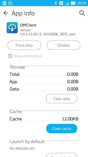

My biggest concern is that anytime I try to check for an update, a message saying "DMClient has stopped working" appears. If I check the app on settings, it shows 0.0B on app data.
Does anyone else has this problem too? Is there a way to fix it?
I'm running stock, non rooted, 2.15.40.13 version
Try rebooting ur device. Or clear the cache data in ur phone. That should probably solve ur problem.
Hi, thanks for the reply.
I have tried those a few times with no success.
I'm thinking maybe a factory reset could help, but I don't really feel like doing that.
Where can I find the latest firmware to sideload it ?
http://click.xda-developers.com/api...ota.asus.com/delta_package/p...9_20150529.zip
Here's the link to the latest firmware. Try installing this in ur phone......
And below is the source link where I got this firmware update link for you, first read this article so u can get a clear look on what's fixed in this update.
http://www.ibtimes.co.uk/asus-zenfo...date-version-2-18-40-12-download-link-1504625
Thank you very much, sideloading the lastest worked (:
Have a good day
