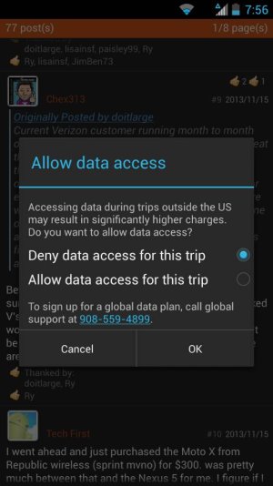

Anybody travel outside the country with their Droid Maxx and have some suggestions on how to get this message to stop popping up?
I'm on wifi that is kind of spotty so I think that might be the problem, but I've already denied access and it has popped up a million times, almost every time my screen turns on.

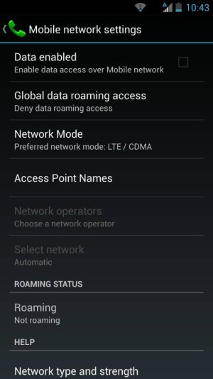

That was actually the first thing I did. I've been turning it on and off playing with settings but it still seems to be connecting to something.
I've also had it on global network, CDMA/LTE, and I actually just switched to the last one- LTE/GSM/UMTS.

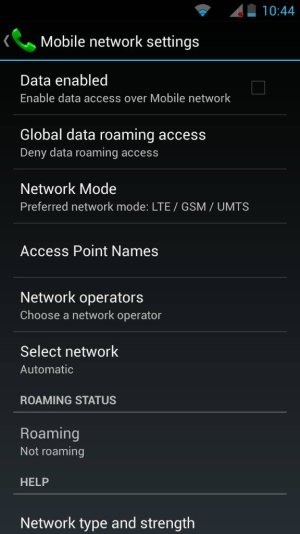

Even with no data (see snapshot #1), the are still bars connecting to something in the top right.
The LTE/GSM/UMTS appears to kill the bars in the top right. Maybe now it will stop.
Will keep you posted.
Snapshot #2 shows the bars gone now that I switched to LTE/GSM/UMTS.

The snapshots didn't upload properly so I just re-did them.
Now that I connected to the LTE/GSM/UMTS, and the bars are gone completely, I assume that means my phone is not trying to connect to any network.
This seemed to work because I haven't had the original issue for about 45 min., which is easily a record considering how ridiculous it's been the last 2 days.
