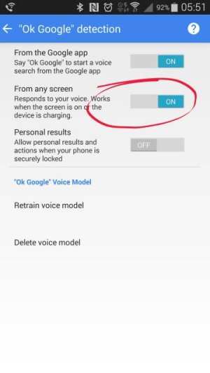

Running Kit Kat (stock) on T-Mobile here. Not sure if it's the same issue, but I'm also having an issue with Google voice recognition from any screen. I have disabled S Voice. While I can select "from any screen" in the Google voice recognition options, it turns itself off if I use the home button to wake the device, or if I use the home button to get back to my home screen.

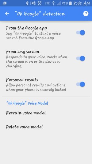

Can you post a screenshot? Does it work with the screen off while unplugged? If no, then this isn't the correct fix, it's just a workaround to partially fix the issue and make the Note 4 work like every other phone out there.
Sent with my thumbs using Tapatalk 4 Vip
It doesn't work if the screen is off, but it works in all other instances (i.e. while locked, on the home screen, within other apps, etc) but the phone has to be awake for that, which I can live with.
{As you can see in the screen shot, the options are no longer grayed out}
