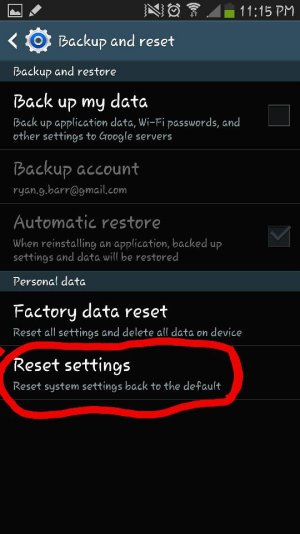

Did you try resetting the settings? if you did or that doesn't work. I can only recommend a factory reset :/ or calling Samsung direct

Well, had reset settings and app preferences buuuut... nada.
