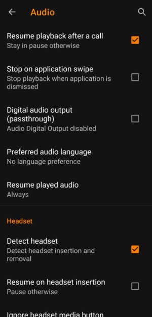

Can try Stop on application swipe, highlight that and when you swipe it away from recent apps does it stop the player from playing? Maybe faster than Force stopping and going through the menus .Screenshot_20251028_064740_VLC.jpg
