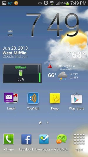

I finally found a car charger that charges my phone over 1 amp.
http://www.amazon.com/gp/aw/d/B00B8...ag=hawk-future-20&ascsubtag=UUacUvbUpU3006666
Anker 18W / 2.4A + 2.0A (3.6A max) Dual Port USB Car. Smallest Adapter to Provide Simultaneous, Full-Speed Charges to iPads and Smartphones. The corded micro-usb charges Android phones at full - speed 2.0 amps, while the usb plug is for Apple.
And it $10 and free prime shipping!
