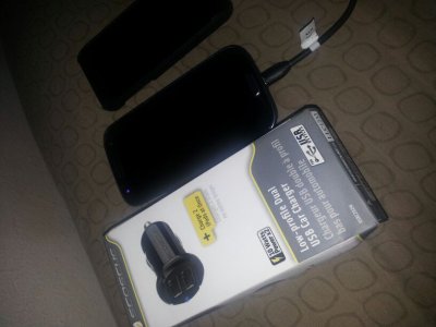

I had an issue charging my i5 in the car. The the old iphone/ipod charger wouldn't work. I had the 1 from AT&T that would charger my I phone... And and an additional USB port. The i5 would not recognize anything I tried. Until I got the SCOSCHE dual USB charger. 10 watts x2. 2.1a each. It works perfectly, and it's a low profile design. It charges my i5, and my GS3 just fine. I haven't tried it on the N2 yet. I just got the N2. I'll try it later and report back. uploadfromtaptalk1351882831771.jpg

I had an issue charging my i5 in the car. The the old iphone/ipod charger wouldn't work. I had the 1 from AT&T that would charger my I phone... And and an additional USB port. The i5 would not recognize anything I tried. Until I got the SCOSCHE dual USB charger. 10 watts x2. 2.1a each. It works perfectly, and it's a low profile design. It charges my i5, and my GS3 just fine. I haven't tried it on the N2 yet. I just got the N2. I'll try it later and report back. View attachment 44439
Based on this, I would say this is a good "Universal" charger. The fact that the charger also works with the tablet seems to indicate that it also uses Samsung's charger detection. Samsung uses 1.2Vdc on some of their devices for D+ and D- to allow full charging.
