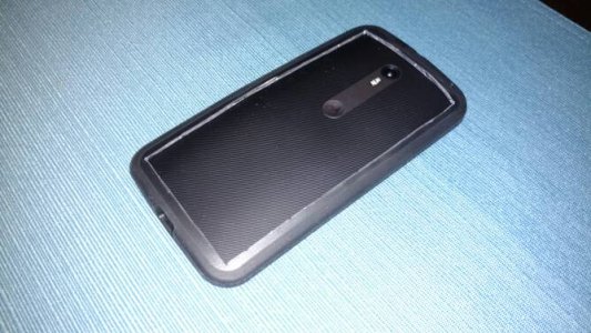

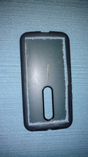

I can't find one anyplace, so I decided to try and make my own.
I happened to have an Incipio Octane case that I didn't care for. It became the experiment.
I used a straw as a guide to draw a border around the area I wanted to keep.
I drilled holes in the corners and around the perimeter of my cutting area and finished the cut with a brown cutting wheel & Dremel.
I then broke off the melted pieces and sanded down the edges with 220 grit sand paper.
It's not as beautifully contoured as the CASE-MATE Tough Frame, but seems sturdy and will get the job done.
I love the feel of the back of the MXPE and the ridge of the bumper allows good grip for finger / thumb removal from pocket.
I also need an open back because I use my phone in a NAV dock for streaming music and Waze, while driving.
It's ok in the winter, but in the summer the phone heats up easily.
