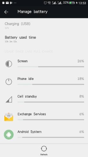

Same thing happening to my Gionee M5 Mini but i can see phone idle using up 18% of my ba3 and not Cell standby.

That's not a free app. That's the system setting (for battery) that came with my phone.
