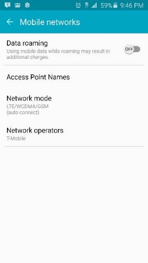

Try going to settings > mobile networks > mobile data > uncheck enhanced 4g LTE.

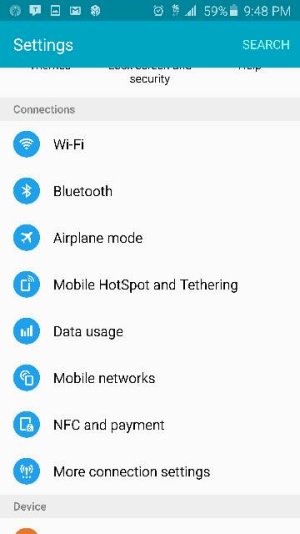

I read about that somewhere but I can't find that option. Here are some screen caps of what I got.
