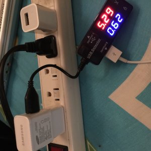

This tool will tell you how much current is drawing to your tablet:
usb current and voltage tester | eBay
This is a 2 Amps Samsung adapter and the drawing current when using to charge an Iphone ( Apple's adapter is 1 Amp )
I will not burn my $800 Iphone with this Samsung 2 Amps adapter.
