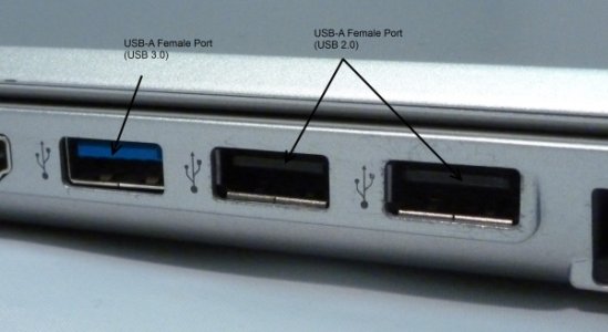

If charging from a PC, check to see if your PC has any USB 3.0 ports - they should be blue in color on the inside. USB 3.0 ports put out 900 mA current instead of the 500 mA of earlier USB ports. Newer PCs typically have a mix of 2.0 and 3.0 ports; on a notebook they can be anywhere, but on a desktop PC the 3.0 ports are usually on the backplane where they are built directly onto the motherboard as opposed to the front accessible ports.
Note: if your laptop has a yellow USB port, that is not the same thing at all. The yellow port indicates that it can provide power even when the laptop is closed or otherwise turned off.
