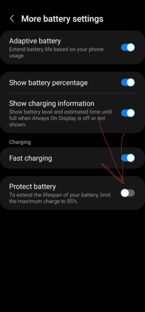

Which charger are you using? I think that model came with a 15w charger in the box but it can accept until 25w. Just in case see if this option is enabled in the battery settings.

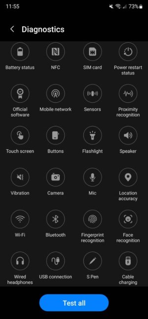

If it's not the battery protection Javier mentioned go to settings>device care >diagnostic and test your battery,USB etc there Screenshot_20220703-115523_Samsung%20Members.jpg
