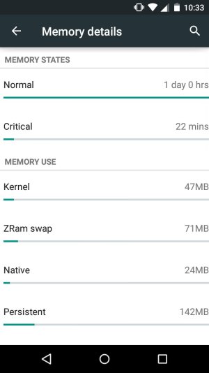

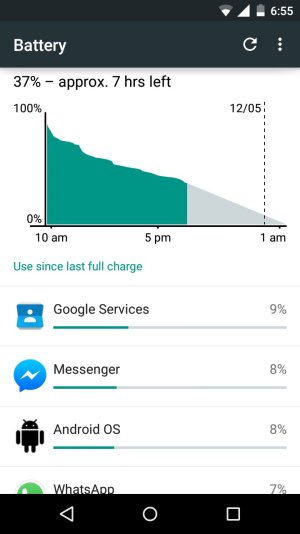

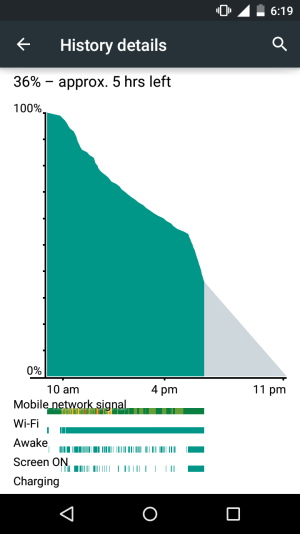

As per the battery stats, 'Google Services' kept my phone awake for around 15 minutes. Is this normal or can something be done?
Also, let me know what you think of the process stats:
Hi,
Nothing on those screenshots looks problematic. Your phone does wake from sleep regularly when the screen is off but I guess that is the multiple messaging apps waking briefly, and maybe location reporting checking in for Google Now if you use it. Google Now or universal OK Google detection would also account for the 15 minutes wake time for the Google App.

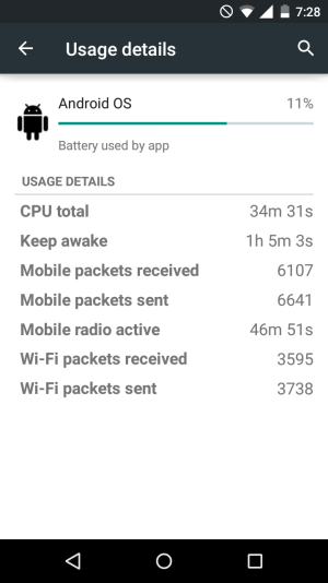

The mobile network at my office is pretty poor and I think the phone struggles to stay connected. Is this why Android OS is keeping my phone awake for so long (as shown in screenshot) ?

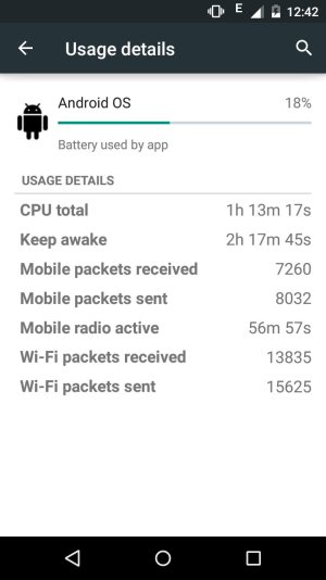

Today's battery stats... I'm not rooted so I can't use Wakelock detector...

Today's battery stats... Can someone please reply?
