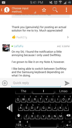

You know SwiftKey can do one handed mode as well (attached below). Just hold the 123 button and press compact instead of full. And if you pull out your S Pen and press the text field you'll see a blue T bubble. Tap it and you can use write to text without the stock Samsung keyboard.
Definitely didn't know about the compact setting. I had looked for S-Pen compatibility and couldn't find a way to make it work, which is what lead me to switching to the Samsung keyboard for that. I stumbled into the one handed setup of that because I already had one handed settings turned on, so the Samsung keyboard took its rules from that.
I'll go mess with the SK keyboard and the S-Pen again, that would be nice to compare. Thanks for the heads up.
