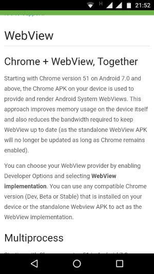

Hey guys, I know webview isn't being used on Nougat anymore, but seems that the embbed Chrome's webview is crashing.
Every app that needs to open a site won't work.

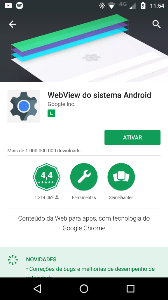

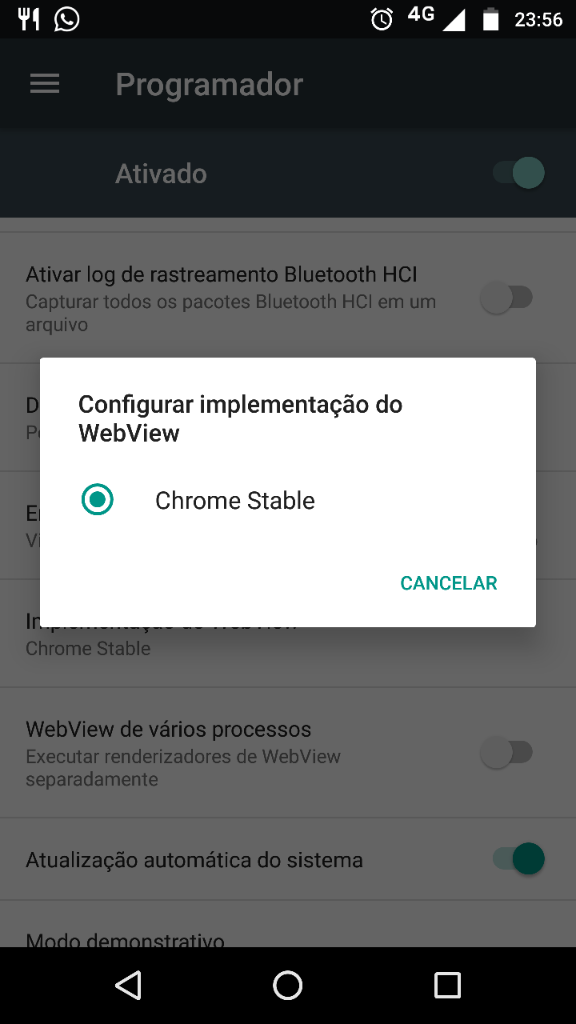

There is no option... I can't switch to Google Webview
I can't activate webview... Even when I disable chrome.
This is what I get in the play store.

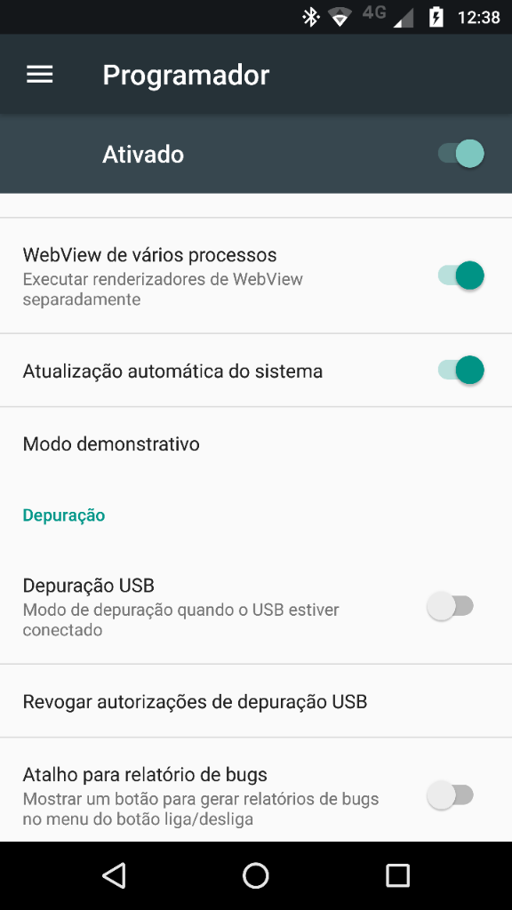

Hey guys, seems that ticking the box "run webview renders separately" does the trick. Not a single crash since then.
The blank screens came back... Ticking the box didn't do the job... I'm thinking about a fresh install of Nougat, but it's a pain in the *** to have everything installed again...

Before that you could try using Chrome Beta as Webview provider and see what happens.
