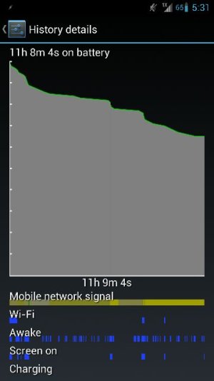

I'm getting a lot of awake time after flashing the 12/8 nightly. Any ideas?
Sent from my EVO using Android Central Forums
