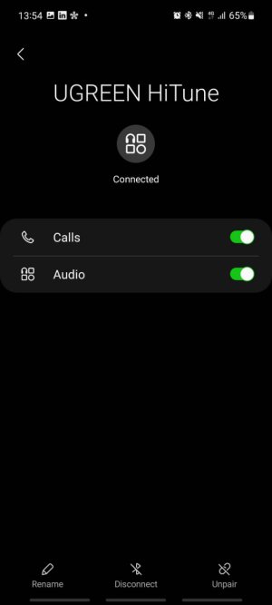

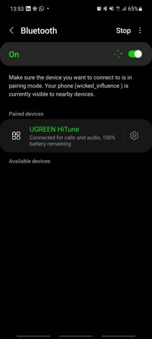

I updated my phone last night (Samsung A52) and for some reason now my earbuds connect fine, but I can only hear calls and not my music or YouTube. I tested everything and it does the same for Bluetooth speakers as well and my earbuds work fine on my other devices. Tried resetting the network connections, unpairing and pairing again and checked all the possible settings to no avail. Nothing online seems to show a fix for my issue either. Please help, Samsung Service Centers are hopeless as well, no one seems to have a clue what's going on. Would greatly appreciate any help I could find. Bluetooth shows it is connected to the earbuds in settings.

I've attached a screenshot of the connected earbuds, advanced bluetooth settings and connected earbuds permissions. Everything seems to be in order but it isn't working. :/ WhatsApp Image 2022-02-15 at 1.55.01 PM.jpg WhatsApp Image 2022-02-15 at 1.54.51 PM.jpg

Isn't it a tad weird that it only started bugging out after I updated my phone to Android 12 - One UI 4? What do you think could have happened? :/
Since it also happens in Safe Mode, that eliminates the possibility that some app you installed is interfering -- I was wondering if something about the system update caused a problem with an app you installed, which in turn was causing problems with the earbud connection.
It certainly could be something in the update that is causing the glitch. Try changing the Bluetooth codec in the Developer Options. (To activate Developer Options, go to Settings>About Phone and tap Build Number 7 times.)
