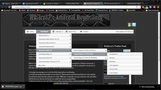

I got a question... The like you provided takes me to another website... rwilco12.com... I go to downloads, find GS2, find my carrier so it gives me the rightGS2 files for the GS2 Epic, it gives me about 5 options... 2 of them are #1 OTA updates, #2 Stock ROM... From the stock ROM, I downloaded "SPH-D710.FI25_CL1123725_Unrooted_Nodata.exe" This made me think, because its a FL25 build, and I need FL24 build... So I then went into OTA updates, And I downloaded "35935f252780.update_SPH-D710_FI27_to_FL24.zip" This one has me confused too, because it says from FL27 to FL24, and I'm using FK23 leaked JB... If you can direct me to the right one by following your link, and finding the right file I should use, that would be a big help... Note; I'm trying to flash back to ICS from leaked JB build FK23... Once I downgrade to FL24, I can then use kies to upgrade to GB27 official JB...1st page.png
It sounds like you want the latest official Jelly Bean release. Just go to: Devices > Samsung Galaxy S2 (Sprint) > Stock ROMs > JB > GB27 > Full Restore > Unrooted > SPH-D710_GB27-1014481_Stock_Restore.exe
That will bring up a program to flash the latest official Jelly Bean release - let us know If you have further questions.
