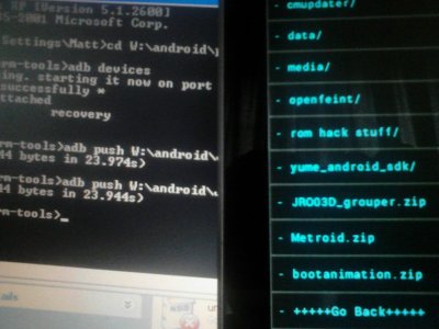

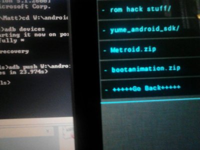

Again sorry for the confusion but my zip was a cm10 nightly I renamed for the video and the first thing you try to push doesn't show up push it again and it should work

Got it! Thanks so much for the clarification. Although, it would've been so much easier to just tell me that I had the wrong file. I could just get the right file and do my thing. :-)

I was in the same adb "session" this time since I was using adb from the command line. Meaning, the daemon was still running from the first push I did. So, while I couldn't see the grouper zip after the first push (consistent with your experience, dark_samus), I could see it and upgrade with it after second push (also consistent). And, perhaps my previous attempts didn't work before because I was closing and opening the Nexus 7 Toolkit each time, therefore stopping and restarting the daemon, which meant that each push attempt was the first attempt for that "session."

Glad you got your tablet back up and running :) the only reason I knew how to do it is because I'd done it once before on mine I had downloaded the first cm10 nightly onto my computer instead of my tablet and was already in recovery when I realized I hadn't transferred it and was too lazy to reboot it transfer it and go back to recovery so when I plugged it into my computer I realized it had adb and tried a push but it didn't work so I tried one more time and it was fine anyways next time MAKE a BACKUP lol
