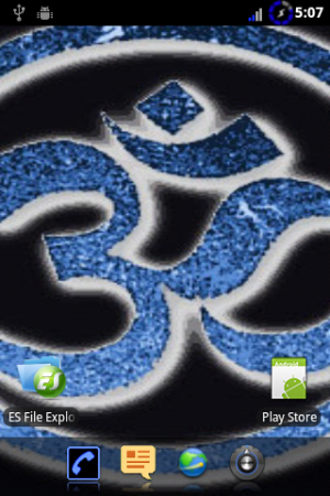

Re: [IHO ROM+KERNEL] OM-Mandylion.....01-05-2013..Update
After setting everything up on previous version.. this is what continues to happen..
SS:
