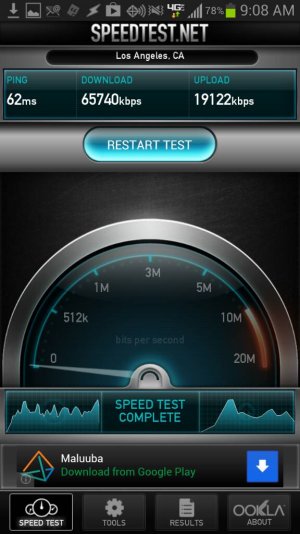

Typically, speed is measured in megabits per second, not megabytes per second. Verizon's 4GLTE network is rated at 72 megabits per second, or 9 megabytes per second. The speed test app measures in kilobits per second, or megabits per second.
One byte being 8 bits.
Sent from my Verizon Samsung Galaxy Note II
