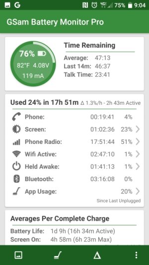

Just wanted to let you guys know that I contacted HTC tech support yesterday morning telling them about the drastic battery life change since the last update, and they pushed a new update to my phone just before noon today that was about 134 MB. I installed it and saw a big battery life improvement, with the phone going from 86% to 84% in two hours, and that included an hour of no service in a mall restaurant. I'm not sure if I'm the beta for this update today (Software number 2.42.617.6), but it definitely fixed the battery problem. I'm going to get back with HTC and let them know the results in a few.

The update is working very well for me. It's lunchtime and my phone has been off the charger for 6 hours with normal use, including a little Google Maps and a lot of music with some app updates, and the battery is still at at 92%.

I'm happy to say that so far, my battery life is back to where it was before the update broke things. That is to say, very good. Whew!
