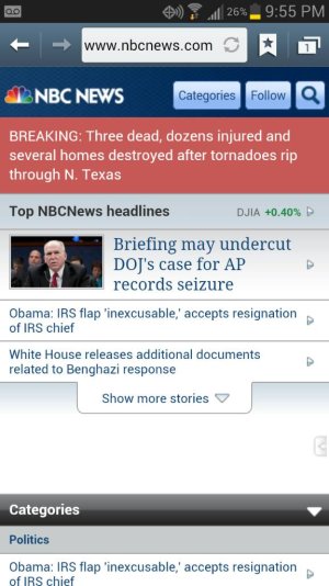

I am having a hard solving an issue with the default browser. I have one website (NBC News) where none of the links function when pressed. They highlight yellow but no new page opens. If worked before and for some time after I rooted my phone. I have cleared the cache and data, restored it from a known good Titanium backup, and restored it again after removing it with Titanium backup. The only time it has started working was when I had the cell store flash 4.1.2 on it. Here again it worked before and after I rooted. I incrementally installed apps and used it for a while to see if another app was causing it. Out of the blue it stopped working again. I don't want to switch to another browser besides the same issue occurs with Chrome and Dolphin although it works with Firefox and Opera.
Galaxy S3 running 4.1.2 rooted stock ROM.

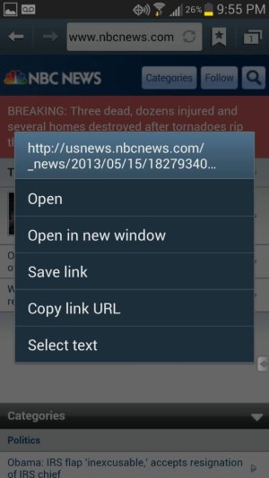

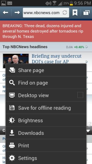

Not exactly sure what to tell you - assuming that this is the site that you're referring to uploadfromtaptalk1368680378164.jpgthen my experience is the same as yours: if I tap one of the story blurbs, it briefly highlights and then unhighlights. Note however that if I long-press on one of the story blurbs, I get this uploadfromtaptalk1368680537123.jpgand if I choose Open then it opens the story like you would have expected. Annoying, but it's a work around. Of course, you could change the browser to Desktop view uploadfromtaptalk1368680676026.jpgbut that rather defeats the purpose.

The longpress then open works. It's a bit of a nuisance but better than nothing and it's just the one url. It's just odd that it used to work and then took a factory ROM reset to fix it for awhile.
