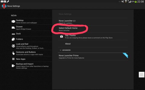

When you open up Nova Settings, you should be able to set it as your default launcher
