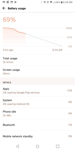

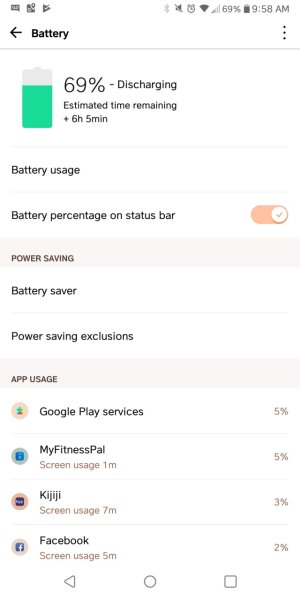

Ok. I removed my phone from the charge this morning and let it run down to 70%. Attached are the screen shot. Hopefully, this captures the data you asked for. FYI, I am running Greenify.
Sorry -- this is a common misunderstanding, but I meant to run the battery down to 30%, not down by 30%. Basically, it's helpful to see what's been using the battery throughout most one full charge cycle.
The relatively high Phone Idle and the fact that there are only 2 bars in your cell signal indicator make me wonder if you have poor cell signal that's contributing to battery drain. As I previously suggested, it might be helpful to look at a graph of the cell signal strength using an app like GSam Battery Monitor.
