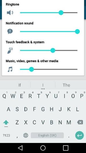

I actually totally just figured out how you can fix this.
On the G4 when you adjust the ringer volume you can press a button to expand your volumes. I attached a screenshot, if you turn down system sounds all the way, it should disable the battery notifications. It did for my phone. :)
I meant to attach this, whoops.

I just tried Adam's suggestion and it didn't work. I disabled the notification volume and put the phone on the charger. When the battery indicator reached 100% the phone made the two-pip notification sound indicating full battery, and the full battery message appeared in the notification menu that appears when sliding the finger down from the top of the phone.
My phone is the LG G4, Android 6.0, kernel version 3.10.84, build number MRA58K, software version V20h-EUR-XX.
It's really idiotic of LG to not give us a way of turning off the battery-full sound notification. It means I can't charge the phone while sleeping. And I don't give a f$%&! that I'm stressing the battery or using more electricity than necessary.

On mine if you turn down the "touch feedback and system" volume to zero you won't hear the battery full sound.
I use Tasker to turn off the notification light and set the System volume to zero during the night so I can charge at night and no sounds or lights bother my sleep. Works every night.
Hit the volume rocker. You will see the volume slider. To the right is the gear. Open that and it's one of the sliders in there.
