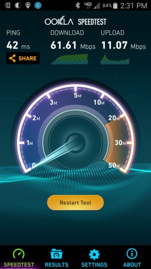

Just for the heel of it did it again on LTE.
With full bars sitting on desk it showed -94 dBm (24 asu)
With finger over the very top of the back and one bar dropping it showed -94 dBm (25 asu)
Using Signal Check Lite
Will add while doing this in using hotspot for my tablet which is what I'm writing this on, plus streaming a sports radio app on my phone. This didn't effect anything.
