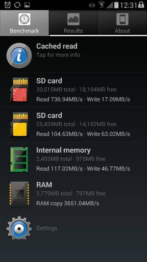

I happen to own a Note 3 running the latest Hyperdrive rom. I'm using a 32 gig samsung pro UHS-1 microsd card.. and I'm getting 100MB/s+ reads & 60MB/s+ writes.
Sorry to revive this thread but I found it while searching on google, and if anyone else comes across it they may be misinformed.
Morphemes, your SD card results are wrong because that is a cached read. It's really hard to accurate results with that app. The only results that are correct are your write speeds.
After writing to that SD card at 17.09MB/s you system placed that data in the cache located in RAM. Then proceeded to read out of RAM at 736MB/s. The reason why it is not as fast reading out of cache is because it is likely compressed to about 33% size. Additionally for each block read from the cache the system needs to verify the block on disk is identical. It does this by only reading the blocks metadata from the SD Card then comparing it to the block read from cache.
To get accurate results, your phone pretty much needs to be out of memory so there is no room to catch it.

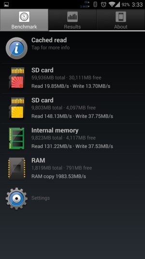

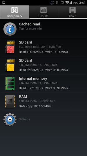

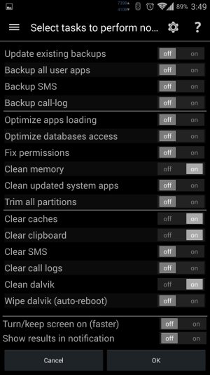

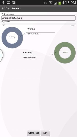

Here is an i545 Galaxy S4. The external SD card is a UHS-I Samsung EVO Class 10 64GB (MB-MP64DA/AM) that was advertised getting 45MB/s that I'm pretty disappointed in. I haven't once broke 20MB's on either my computer or Phone.
These results are in a dirty state with the memory full and only able to cache little. (Notice there is still the app warning of a Cached Read):
Now using the 3C Toolbox Pro to clear the ram with the settings shown on the left, the system will be able to cache the data then get absurd read speeds as shown on the right. I did the tests starting from bottom to top, notice it gets slower as more cache is filled:
I have no idea how it determines when to clear the caches.

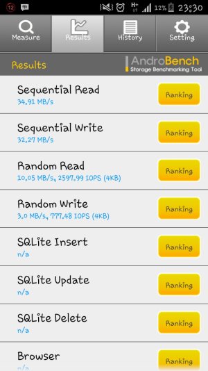

I've tried using microSD sandisk extreme 32gb UHS-I class 3 on my Samsung S4 (i9500), the result is satisfied.
I was used the SDcard test application androbench completed with random test, and here the result :
If you try using androbench application, please make sure you choose the external SD ( /storage/extDsCard ) before run the application, so you will find the right result.
