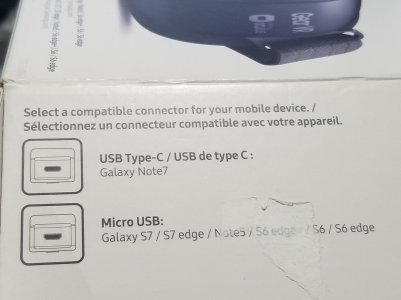

Ok guys, This past month november 17, I bought 2 of them because we have 2 Samsung S8 in our family. I thought it is perfect to have 2 so that 2 of the children can play with each other.
Both boxes are complelety identical in writing and dimensions however
Box 1 has NO sticker.
Box 2 has a little sticker that shows the adapters we have all seen here attached.
I opened box 2 and it has 2 adapters. The S8 does fit once you figure out the ends move to close in on the phone as arms.
Box 1 does NOT have 2 adapters and ONLY has the micro USB. NO USB TYPE C.
I cannot get the phone to work with the S8 for the controls in the head set. I am not sure if it is broken. But if I put a VR program on that is not dependent on the controls, it works fine.
I think Samsung was manufacturing the SM R232 with the micro USB then changed in mid production to have both micro USB and Type C USB.
I think that is the mystery. Ok i hope that helps and I hope I can figure out how to get the glasses and phone to link up for the side glass controls.
That is because Samsung used the same model for both the Note 7 (USB C) and the S7 series (Micro USB)...doesn't look like they changed their mind. The one's received with Note 7 and after its released included both the adapters in the box.
