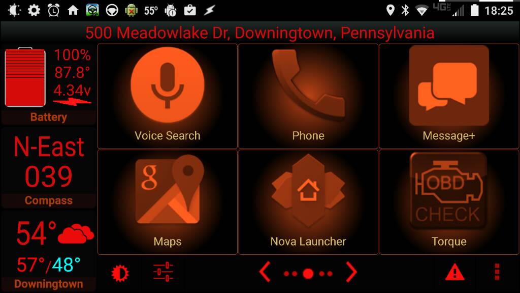

Car dock mode does Activate, but I have car home ultra running.
The little steering wheel is the car mode
