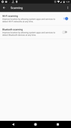

Is wi-fi scanning turned on? That can be found in different locations depending on the phone On my Nexus 6P, it's in Settings>Location, then Menu>Scanning>Wi-Fi Scanning. On the Note5, it's in Settings>Privacy>Location>Improve Accuracy​. Not sure where it is on the V20.

Do you have this option on? Under location > Advanced? Also check under WiFi > Advanced and ensure you don't have it set to allow Google to randomly check WiFi networks around you.

Sitting idle overnight. I shut off wifi and bluetooth scanning. Didn't happen at first. Used to get 100% overnight. Then 99. Then 98. This morning only 95%. Always charge fully before going to bed. Leave phone face down which I think shuts of second screen. Phone idle and wifi use the most battery even wifi and wifi scanning are shut off. I wondered if shutting off "wifi stays awake" setting would do anything? I've tried wifi on and wifi off. Doesn't seem to matter. Wifi using about 2% of battery every night. I was spoiled by the great numbers the first week. 95% Isn't horrible after 8 hours but had been pretty consistently at 98% or better before. Phone seems to go about 6 hours with no drain at all then last 2 or 3 hours it drains.

I mean did you check for those settings? The settings I am talking about allows Google to fire up your wifi and bluetooth to scan nearby devices at random. Even if you shut them off before you went to bed.
wifi scanning right? it's off.

Keep Wi-fi On During Sleep only matters if you have wi-fi turned on. If that setting is off, then even if you have wi-fi turned on, it will turn off when the phone is asleep. However, the wi-fi scanning option we've been discussing can allow the system to turn on wi-fi (sometimes very often), even when you have manually kept it off, in order to improve location accuracy.
