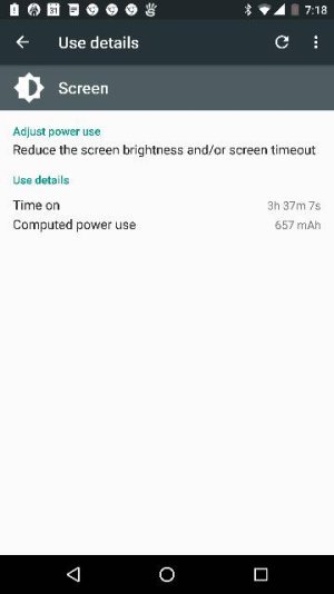

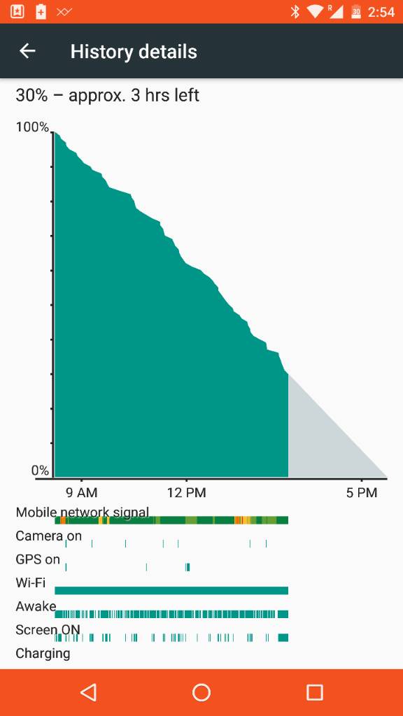

So I have been noticing my Nexus 6p hasn't been getting as stellar battery life as of late. I've had it for maybe 2 months and am having trouble making it through the day with only getting 3 hours of screen on time with mainly texting and some light gaming and video watching normally on WiFi. I decided to do a test last night to see if doze was working and below you'll see my results. Can anyone give me some tips. I'm not looking to do a factory reset but this is frustrating. It doesn't look like there is any one app killing my battery. Bluetooth is on because i use a moto 360.
A couple of more common apps that cause issues are GasBuddy, WeatherBug and MyRadar -- they keep the phone awake so long as Bluetooth is on (even if inactive). Unfortunately, Android doesn't show these apps as using battery, for some reason it tends to report wakelocks under Android System or OS. Another battery app, such as GSam or Wakelock Detector will do a better job of showing the app causing the issue, though even then you may need to be rooted for them to fully work.
Just uninstalled WeatherBug I'll let you know the details on improvement, thank you

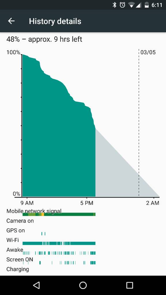

Quite a bit better, I'm at about 65% brightness and watched an hour+ of Netflix and YouTube and streamed music
other than the play store updates, that's a lot of notifications on the top left. also 65% brightness with Netflix will drain your battery really quick. hopefully you'll be able to identify a rogue app by continuing to individually uninstall each one ... unfortunately there's no easier way to do that.
