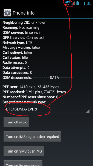

How-To: Turn off 4g/lte, and only allow 3G max
open dialer
dial *#*#4636#*#* (when you press the last *, testing menu will open)
select phone information
change LTE/CDMA/EvDo
to CDMA auto (PRL)
press home button to exit, may take a few secs to change.
Edit: marked up screenshots
also several apps in play store that will also do this search: 4g lte toggle
just an option to try
tested on Verizon, no guarantee that it will fix losing 3g
