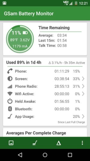

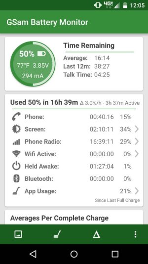

Is this the average you guys are getting? Only been through about 5 charge cycles so hopefully it improves a little. I wasn't expecting 48 hours, but it seems quite a bit weaker than I anticipated. Coming from a DT1, it's not quite as good it seems.
Let me know what you guys are getting for battery life, I'd appreciate it. Thanks
Based on the icon in your screenshot and the high phone radio use, I suspect that most of your battery issues are due to low mobile signal. If your signal is low, the phone sends more power to the antenna to try to hold it. Do you usually have low signal?
Mattsg430
Oct 31, 2014
374
Visit site
Yeah I usually do have low signal due to being in an office with poor reception. I've even noticed it jump to 3G and then back to 4G occasionally. Must be a significant culprit. Damn.

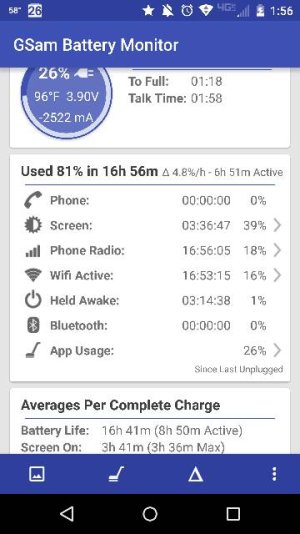

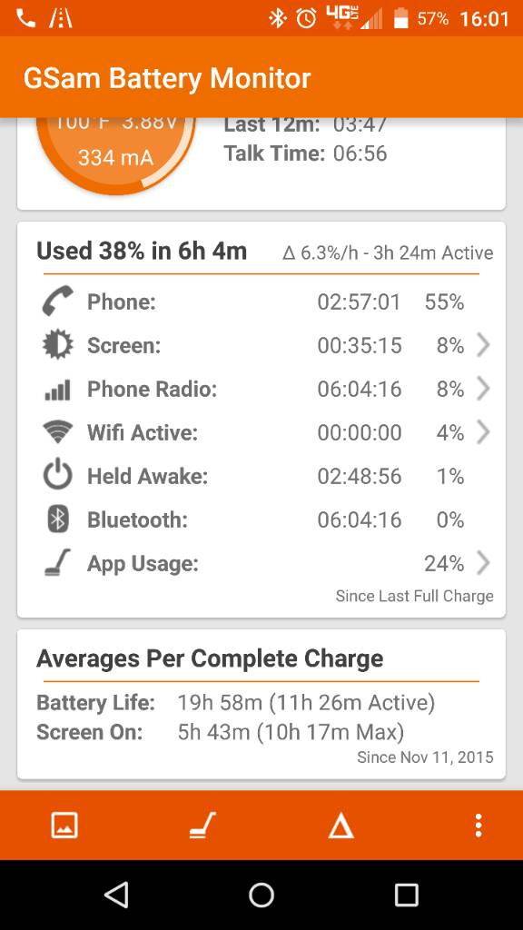

I'm averaging about 28 hours on this phone with about 4 hours, 20 min SOT. If I were more active over an 16-18 hour period I'd expect to get closer to 5-6 hours SOT. My Turbo 1 seemed to be a little more efficient with the screen, but the standby time wasn't nearly as good. I would have to charge every night no matter what and was averaging about 4 hours, 30 min SOT but with only about 20 hours on a single charge. So I'm getting about 8 hours more time with this phone and legitimately do not charge overnight some nights. Here's my current cycle. This is all on network and a ton of emailing. I have 1 corporate email, 2 very active gmails and 1 yahoo account all auto pushing, in addition to a ton of chat on whatsapp, which seems to hit the battery pretty hard. I also had a Droid Maxx and I have to say that was the most battery efficient phone I've used to date. I once got 7.5 hours on that over 38 hours, but that seemed kind of flukish. I averaged closer to 5 hours SOT on my Droid Maxx and I usually charge overnight, but I could consistently get to 28-30 hours on that phone. I don't think I used whatsapp at that point though so that might account for the difference.

Those are good numbers. I see you aren't using WiFi and since I have turned mine off, I'm getting consistently better battery (wifi at my office sucks)
